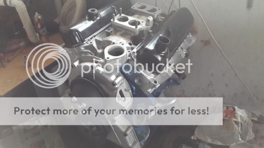

BIGSIX wrote:Ok Motor is starting to come together, put the stuff I could together as they were gathering dust.

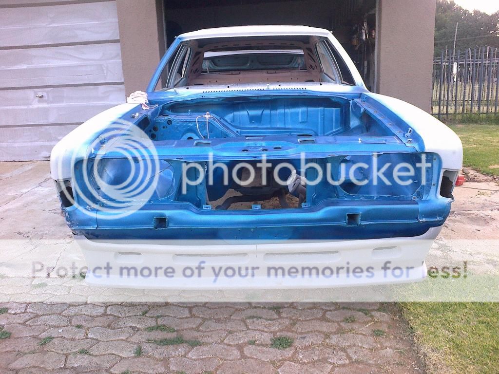

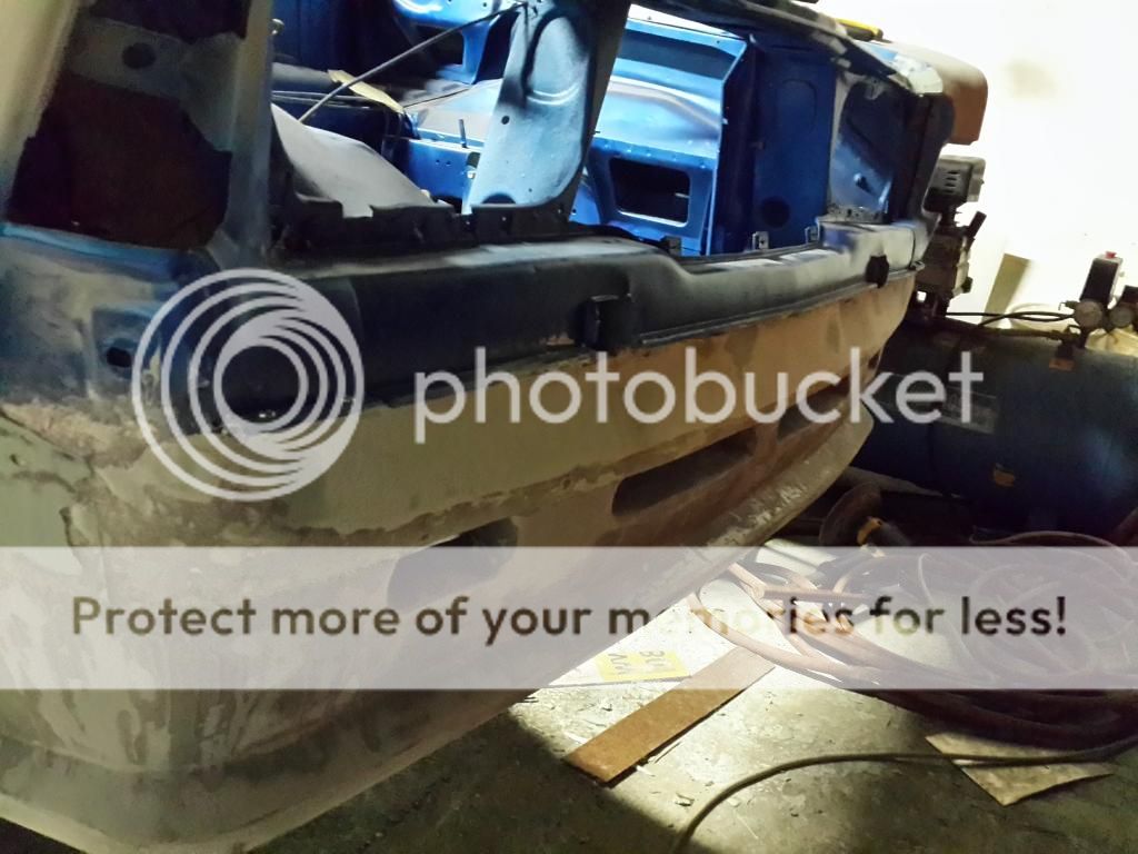

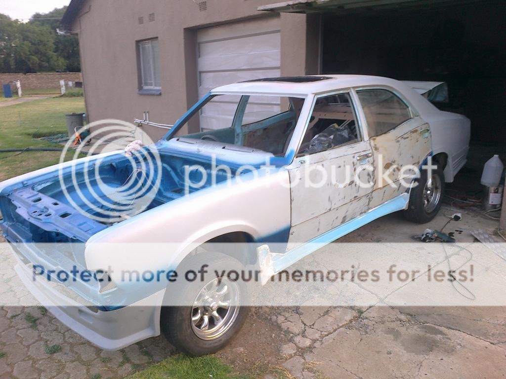

Ok got some work done on the body side skirts and front spoiler.
I know this is not to the liking of most die hard Ford fans but the spoiler kit has grown on me from the first time I saw it 15yr back on the car and I will try my best not to make it into the Zef-Spotting tread.
Some pics of the progress.

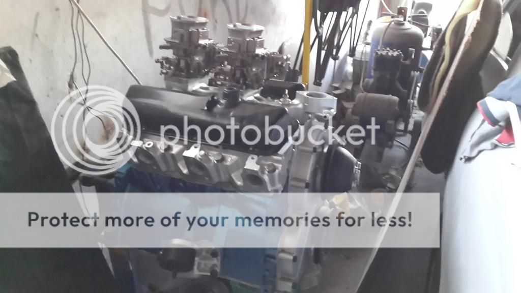

Redone the 2 X 38 Weber Carbs and mocked up my V8 Filter.
Not sure if I should run a single V8 Filter or run two separate square filter on the carbs? Any opinions?
Twin Setup without the links
Filter mock up?
Filter mock up?
