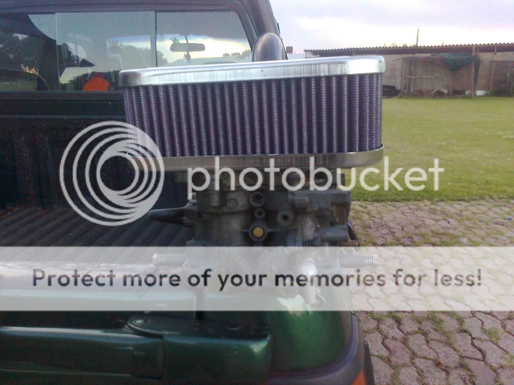

The motor alone as it stands now has cost me close to R12k without the labour as I have done everything myself.
Hoping the filters will clear the bonnet as I don't want to cut it.

Include the distributor in that air cleaner mock-up, sometimes the distributor/spark plug wires can have very little clearance with such a big filter.

I would show off those two beauties, each with their own small filter...... They will be hidden beneath the large one BIGSIX?!

Perhaps consider fabricating some sort of plenum with 90' bends in it so you can mount two filters, DCOE style, one over each tappet cover. That way you'll have plenty of bonnet clearance.

IJ I will check clearance with the distributor fitted, forgot about that?

I would agree with Ters .....go with the individual air filters....

I can get these filters for the carbs, will need to lift them a bit for clearance above the ram tubes thou.
Feedback?
